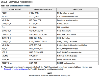

In my case for testing of CMU_FC: -
I am setting the Max and Min value of RCCR register then SR register is informing via FHH and FLL register accordingly depends upon the RCCR value configuration also interrupt is triggering for CMU_FC _1 but according to NXPS32K3XXRM destructive reset should be occur for respective clock. But when I try to read the FES register of MC RGM module bit 8, 10 and 12 is not going to set for CMU_FC1, CMU_FC3 and CMU_FC4.?
My expectation is here, I am creating the scenario of clock failure, so destructive reset should be trigger by MCU once the clock failure is reported. But my case SR register is reporting also interrupt is triggering for respective CMU_FC but not able to see any destructive reset reported by MCU.

CMU_FC:
I think your case is incorrect. Look on the Destructive reset sources table on S32K3:
CMU_FC _1 is not a Source module that triggers a destructive reset.
Another point is that the status of destructive reset should be checked on DES register instead of FES register as your check.
