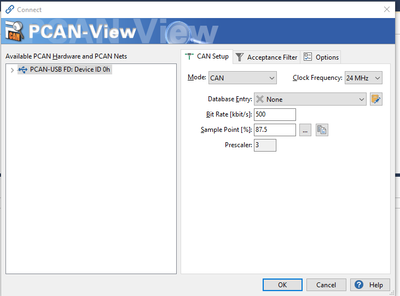

Hello Community,
I am trying to send data through can0 bus.
My motto is to verify whether the can module is working or not.
I sent data and verifying through PCAN View. In PCAN View I got PASSIVE error during receiving the data.
I have attached my project and SS, Please have a look and help me to solve the issue.

most probably you have wrong CAN bit timing. Check if CAN tool use the same setting as your device.
BR, Petr

Hello @PetrS,
I am attaching my settings for your reference.
Any issues in my code to transmit the data. If you have any example for send and receive please share it with me.
