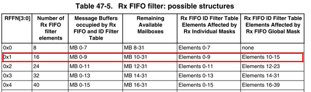

I'm having some troubles filtering CAN messages. Specifically, the RX individual masks don't seem to be doing anything. I am using the global Rx Fifo mask which does work. I have my CAN configured with 16 Mailboxes, 16 RX FIFO Filters, Use Rx FIFO, and the Payload Size of 8. From what I read in the reference manual, Table Elements 0-9 should be affected by RX Individual Masks when enabled. What I don't know is how to enable them. I don't see any registers that enable them. I thought they're enabled when setting them using
FLEXCAN_DRV_SetRxIndividualMask(can_instance, FLEXCAN_MSG_ID_EXT, 0U, 0xff0000);‍‍‍
What exactly am I missing here? Right now the messages are only filtered based on the global mask and my ID table elements.

The Individual masking is enabled by MCR[IRMQ] bit. Once set the individual RX masking is enabled. The ID Filter elements then use RX individual mask registers and RX FIFO global mask register as per setting of CTRL2[RFFN]
For your setting above highlighted option is valid.
The FLEXCAN_DRV_SetRxMaskType (FSL_CANCOM1, 1) is used to set the MCR[IRMQ] bit. Must be written in Freeze mode.

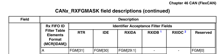

Thanks for the information. I actually tried that before and the individual masking wasn't working. I did some testing with each bit in the message and learned something interesting. The individual mask value had to be shifting left by one bit. For example, I had ID Filter Tabe 0 as
0x00E80000
an originally had Individual Mask Element 0 as
0x00FF0000
I expected a CAN message with ID 0x00E8FF00 to be received. I didn't get the message. so I tried 0x00E84F00. I received this message. The CAN messages are correctly passed when the original Individual Mask Element 0 was
0x01FE0000
All of my individual masks function correctly when I left shifted the mask value by 1. I didn't dig into the drivers. I am using the ProcessorExpert function
FLEXCAN_DRV_SetRxIndividualMask(can_instance, FLEXCAN_MSG_ID_EXT, 0U, 0xff0000 << 1);‍

1. CAN_ID_EXT_MASK would only set the extended ID part of the ID even though the maximum possible value of an extended mask would be 0x1fffffff
2. If RX is set up to use a FIFO then we need to look at RXFGMASK register to see what the bits mean. In the CANx_RXFGMASK definition, if we have selected to use full RXIDA format then the ID would be bits FGM[29:1]. So therefore we would need to shift by 1 bit (as you have done)
This is the solution I had for this issue. I modified the driver so
FLEXCAN_HAL_SetRxIndividualStdMask{
CAN_WR_RXIMR(base, msgBuffIdx, ((CAN_ID_STD(stdMask))<<1));
