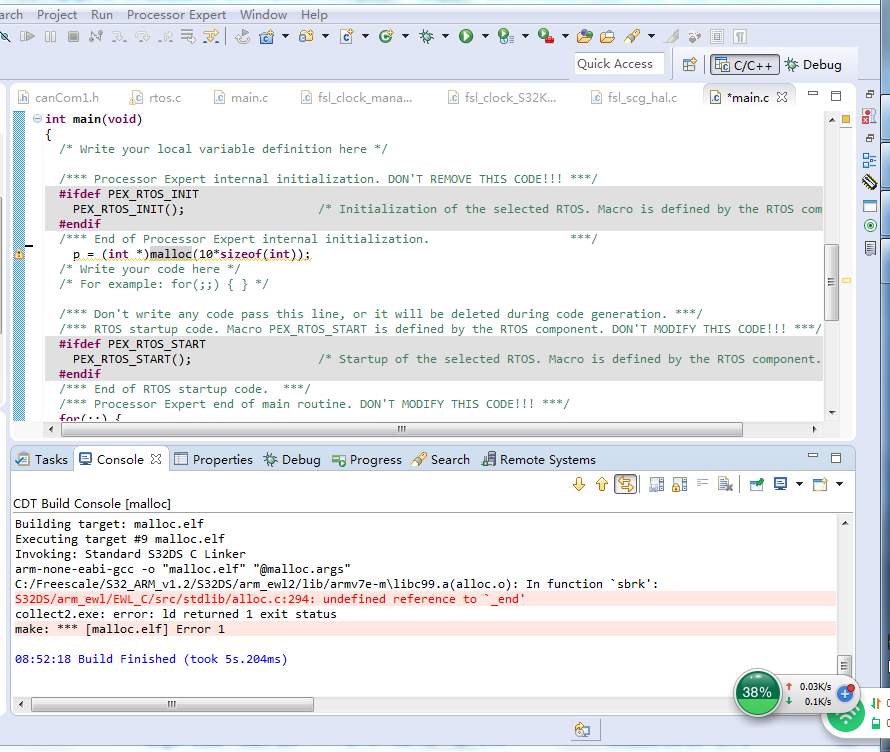

  I want to use the malloc functionin S32k144 broad,when I  #include "stdlib.h", There is an error
“Description Resource Path Location Type S32DS/arm_ewl/EWL_C/src/stdlib/alloc.c undefined reference to `_end' T-BOX-S32k line 294 C/C++ Problem”
How do I use right he malloc functionin?

which version of S32 Design Studio you use?
I tested malloc function in S32 Design Studio v1.3 and it works correct. Also in version 1.2 I am able to compile following code while I am using EWL library.
int *p;
p = (int *)malloc(10*sizeof(int));
Martin

   I built a new project in S32 Design Studio v1.2, the use of malloc functionin, to quote the following wrong me. I am using EWL librarypro.png

I found en error in linker file, which is provided to project with SDK.
Please see the figure below and add the marked symbol to your linker file
