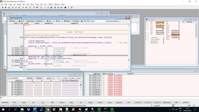

I met a fault when initial RTC using mcal
BusFault: A precise (synchronous) data access error has occurred.
Possible BusFault location: 0x40288004.
HardFault: A fault has been escalated to a hard fault.
If I run the program directly, everything is OK

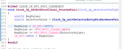

but when i run the program from boot, the program crashed in line 475, the fault is above.
the chip is S32K312
can anybody help?

Hi @danielmartynek ,
We are working on S32K322.
We are also facing same issue in Clock_Ip_SetRtcRtccClksel_TrustedCall()
What could be the possible reasons of failing?

Hi @LewisThin,
Is PRTN1_COFB1_CLKEN[REQ34] set?
