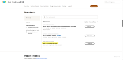

Julián_AragónM
Hi @Ashish4525,
In order to import examples and create application projects with the MCU's resources, it is needed to install the RTD packages. You can follow this guide on how to use the "Updates and Extensions" tab for installing the software: S32DS Extensions & Updates: Explanation and How To Use - NXP Community
You can download the latest RTD for the S32K1xx family from the following page: Real-Time Drivers (RTD) | NXP Semiconductors
Download the UpdateSite.zip file and install it through the Updates and Extensions tab. After restarting, you should be able to see the derivatives and examples for the S32K1xx.

Julián_AragónM
Hi @Ashish4525,
"inside extension updates only The S32K1 Real Time Drivers AUTOSAR 4.4 Version 1.0.1 is available so shall I install this RTD version?"
Have you installed the RTD package for the S32K1? If not, install that version and try to compile again.
Also, the latest version is S32 Design Studio for S32 Platform V3.5, you can try to use this latest version instead: S32 Design Studio | NXP Semiconductors
After you installing version 3.5, you also need to install RTD separately, which can be found through this link: Real-Time Drivers (RTD) | NXP Semiconductors
Julián

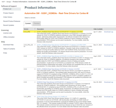

Julián_AragónM
Hi @Ashish4525,
This may be some issues with libraries and version. First check whether you have installed the IDE and SDK correctly, are you using S32 Design Studio for S32 Platform V3.4? Is S32K3 RTD AUTOSAR 4.4 Version 2.0.0 installed? S32 DS has to be updated to V3.4.3 when using RTD 2.0.0.
Is this an example? Or a new project? If this is a new project, you could confirm if this issue happens on an example.
