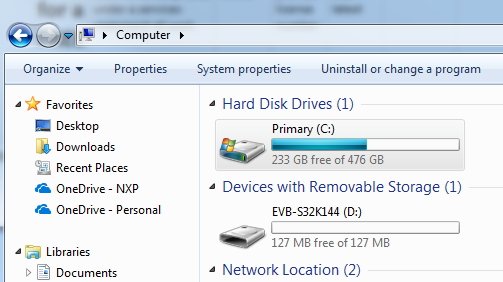

With FRDMPK144-Q10 board you can easily program the created S-record using OpenSDA - Mass Storage Device (MSD).
Just plug the board via USB cable and EVB-S32144 removable storage should appear.
Then easily drag&drop your srecord file into this drive and it gets programmed.

Yes, I have custom bootloader and app. I merge both srecord files and copy it to "evb drive", everything work well.
I dont need second bootloader, just wonder how to flash both bootloader and app into uC.
