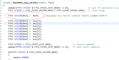

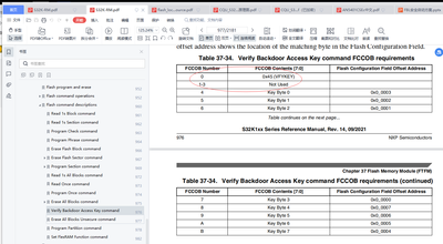

when Using a backdoor key to unlock security, as follow, manual config
but, the config of example code, as follow:
Both is different. I try the config of manual, do not disable secure.

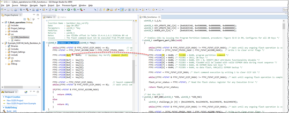

A2. FTFC->FCCOB[3]  point to FCCOB0 which used to fill with Flash command(You can refer to the source code of AN5401SW\3_Basic_operations)

lyz
thank you very much!
I know this. But forget FTFC->FCCOB[3] point to FCCOB0
