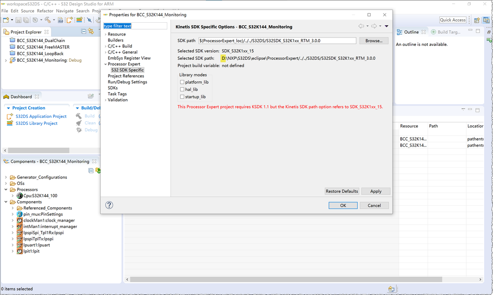

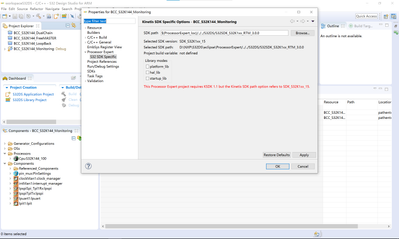

I am using S32K DS 2018.R1 to run the BCC monitoring example (using MC33771C). And there is a window pop-up shows that this project runs on the Kinetis SDK not my current SDK. I then choose continue. The software told me to change the SDK. What should I choose?

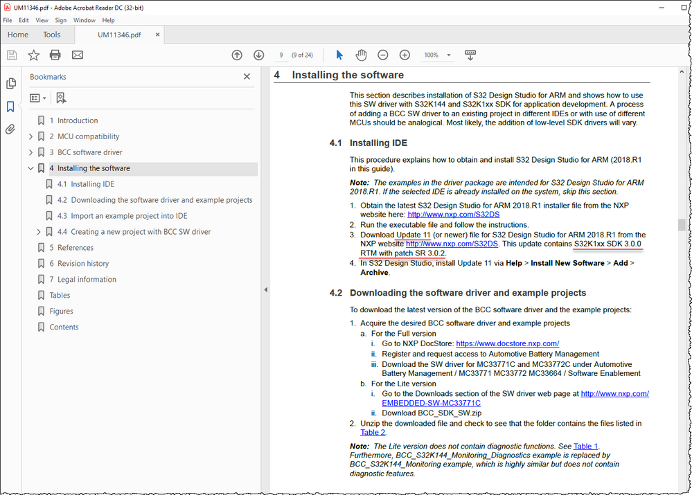

Did you follow the UM11346 and then install the S32 Design Studio for ARM 2018.R1 - Update 11?
Robin

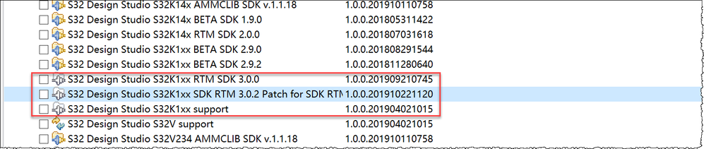

Zyuan17
The problem is solved. The simplest way is just to install all the SDKs.

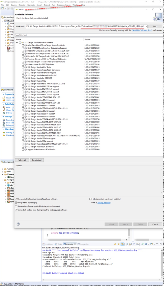

3,453 次查看
Robin_Shen
After uninstalling and reinstalling S32DS, I offline install(Help->Install New Software) the whole S32DS_ARM_v2018.R1_UP11.zip.
As you can see the I select all, and all these turned grey.
This is yours:
The Selected SDK path of mine is C:\NXP\S32DS\....(I install S32DS in C drive.)

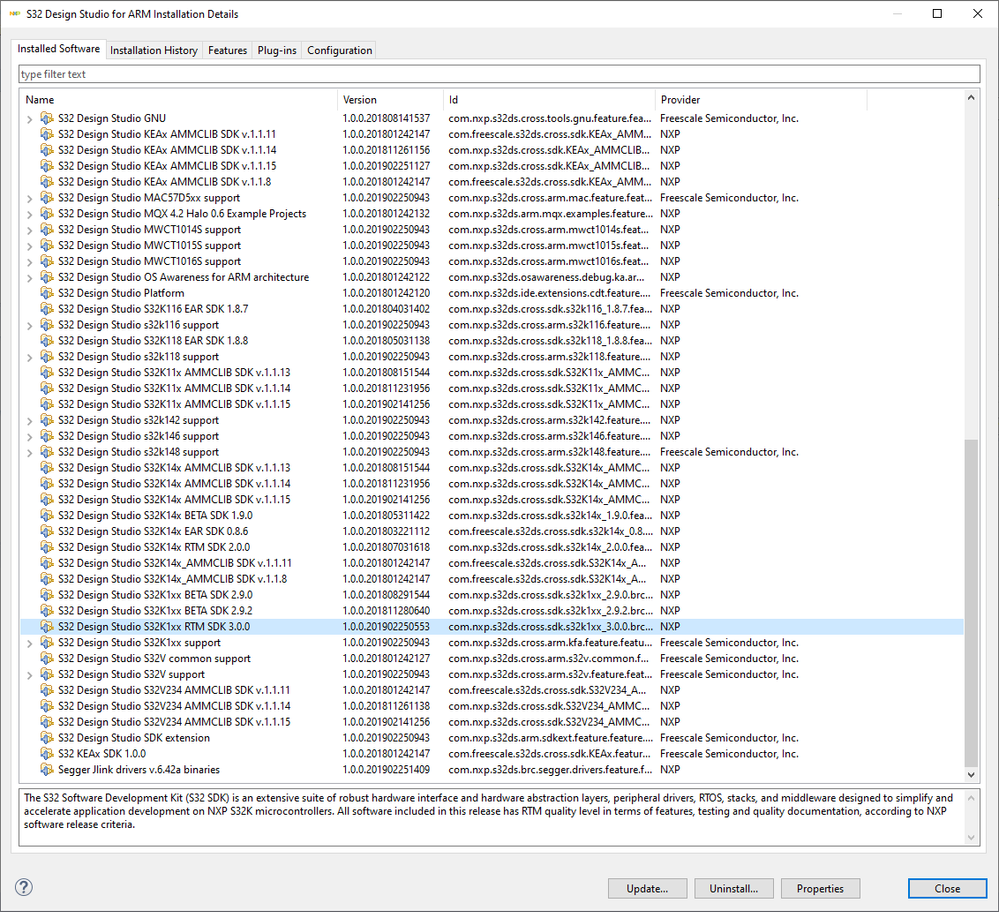

Zyuan17
As you can see, the SDKs are already installed.
