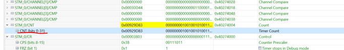

Hi, I have a problem when using OsIf_SuspendAllInterrupts() and OsIf_ResumeAllInterrupts() .
I setup a simple project with STM0 in a 5ms periodic interrupt . When I call OsIf_SuspendAllInterrupts() and then call OsIf_ResumeAllInterrupts() immediately  the timer resumes and runs normally.
But if I do some "heavy work" betweeen these two functions, for example a soft-delay in several minitues, the timer cannot resumes.
My board is S32K344 EVB RED.
Thank you for any help.

Hi@wjhtu
When you turn off all interrupts, SMT will still count. Then turn on interrupts after a delay, at this time, the value of CNT is already much greater than the set trigger value, and it will no longer trigger interrupts.
So you can try clearing SMT->CNT after calling OsIf_ResumeAllInterrupts, and everything will be fine.

wjhtu
Yes, it does work! Thank you very much!
