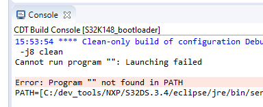

Hi!
I downloaded the AN12218SW and imported the project for the bootloader and the example into the S32 Design Studio.
I generated the code files, but somehow the project does not compile.
It says that there is no Path

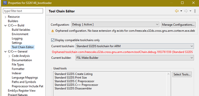

Searching trought the settings I noticed this message:
Am I missing something?
Christof

Robin_Shen
Hi Christof,
Seems that the project is generated by S32DS for ARM, but you are using S32DS for S32 Platform.
Robin

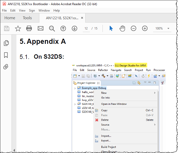

Robin_Shen
You can use this project with S32DS for ARM IDE, or refer: Migrating from 2.2ARM to 3.4DS: Errors occurred during the build
