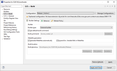

The new Design Studio for S32Platform 3.4 has some features I need and therefore migrating from S32DS for ARM 2.2 was the obvious choice.
What I did:
  1. Install DS 3.4
  2. Point to old Workspace, click on OK when asked to migrate.

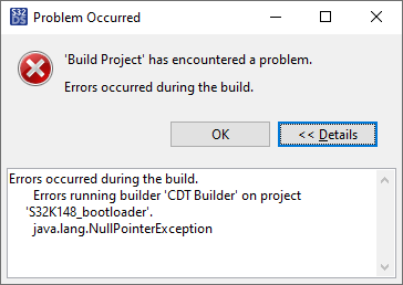

  3. Open project, refresh, clean and BUILD
When checking the Project Properties this warning poppes up:
Orphaned configuration. No base extension cfg exists for com.freescale.s32ds.cross.gnu.arm.cortexm.exe.release.508611179
And when checking the Tool Chain Editor:
Orphaned toolchain com.freescale.s32ds.cross.gnu.arm.cortexm.toolChain.release.470831999 (Standard S32DS toolchain for ARM)

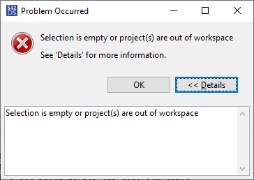

Renaming the project yields:
Selection is empty or project(s) are out of workspace

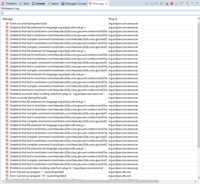

The error log looks like this:
How do I fix this?

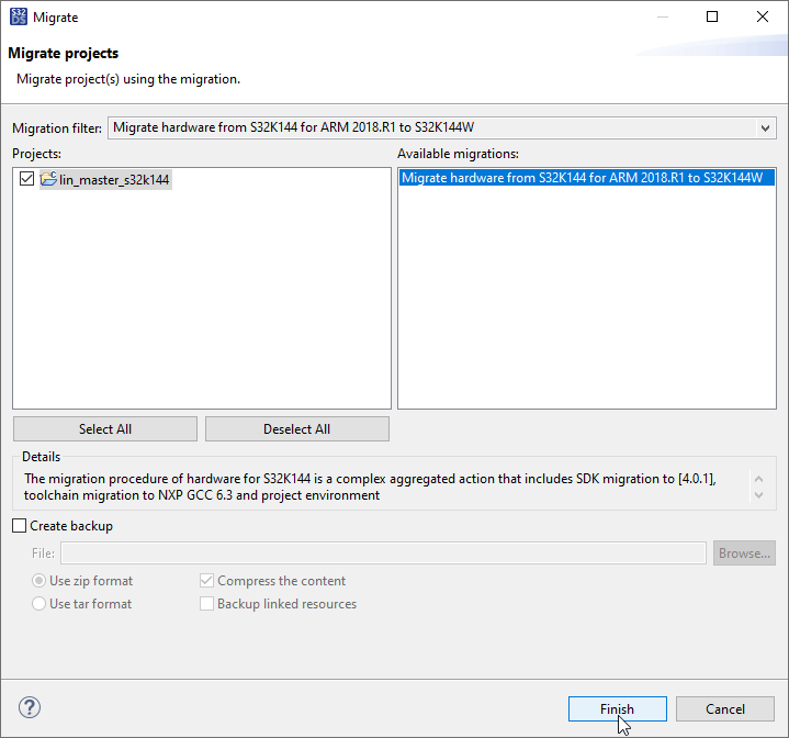

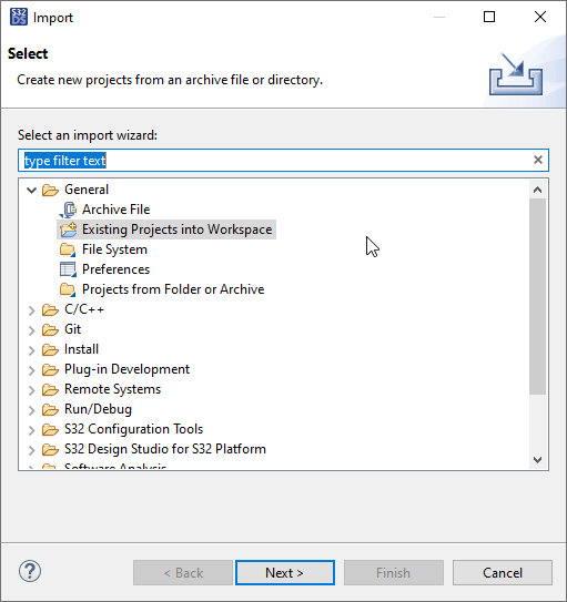

you need to use Migration tool - here are steps which works for me:
Import S32DS v2.2 project (File -> Import) into existing S32DS v3.4 workspace
When done - select Migrate (File -> Migrate)
Select your project and click on Finish button.
Jiri

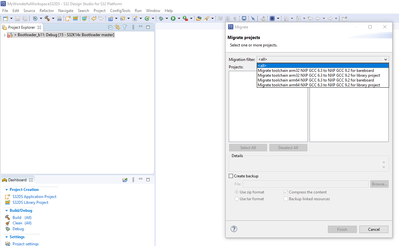

Hello Jiri,
The options in the Migrate filter dropdown are quite limited in my case:
Am I missing some prerequisite?

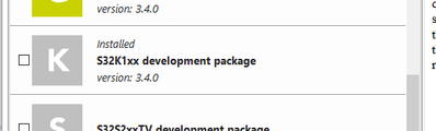

EDIT:
Under Help -> S32DS Extensions and Updates -> S32K1xx development package
This needs to be installed for the filters to appear.

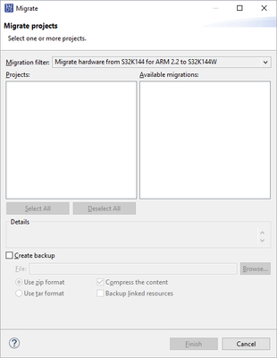

Migrating is still impossible though as the Project is not selectable:
With regards,
Roy

jiri_kral
Try to choose migration from S32DS 2018.R1 - some projects aren't detected as a v2.2 because uses the very same toolchain as is used in older S32DS.
Installing S32K1xx SDK also extends migration ability.
Jiri

roy_vanlierop
Hello Jiri,
My project is still not visible in the migration wizard.
What I did to solve the problem:
  • Create new project
  • Copy Source/Header file to new project
  • Set your includes correctly
  • Build
This would only work for a relatively simple project without any SDK dependencies. It also fixed the renaming of the project as this is a whole new project.
S32DS 3.4 does not seem to index my project correctly if it's not inside the Workspace folder structure. This seems to be a separate bug that also hinders the Migration Tool.
