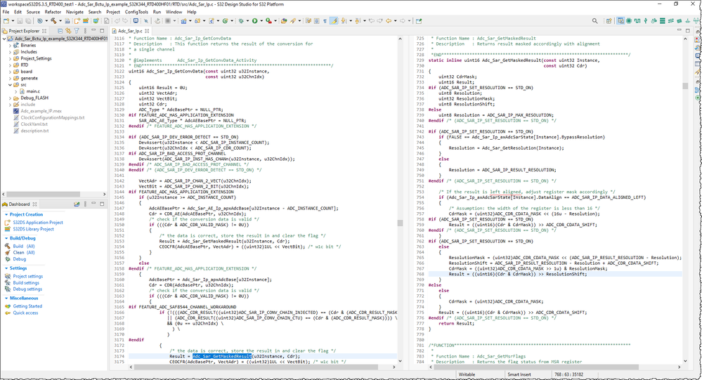

Just want to double-check my understanding: for data that's right-aligned, does the ADC resolution start at bit 14? So, essentially, bit 14 is always the Most Significant Bit (MSB) regardless of the resolution, right? I'm just curious about why bit 0 wasn't chosen as the Least Significant Bit (LSB). Any insights on the reasoning behind this? Thanks for helping out!

See Adc_Sar_Ip_GetConvData and Adc_Sar_GetMaskedResult. Your understanding is correct.
Sorry, I didn't find the reason for this design.
