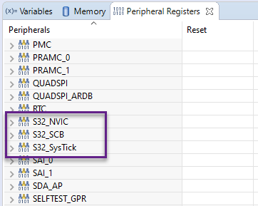

3. With S32DS, how can i access the MMFSR register and other registers ? I am using a PE-Micro debugger.

3.
There are some core registers but not all of them:
12,266 Views

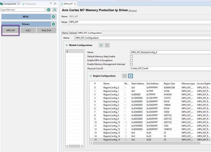

2. I see that we can only have 8 entries if MPU is enabled. As i am not going to use ITCM region, can i use that index in MPU table for DTCM1 ?
Regards, Biju
12,257 Views
danielmartynek
1. Yes, the CM7_0 can access DTCM0 directly and DTCM1 via the backdoor access.
2. There are 16 MPU descriptors, it is up to you.
You can use the RTD driver for it.
