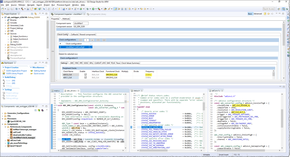

Actually I am trying ADC_swtrigger  example code for S32k144 board.
Code struct at the highlighted line that is asserting Clock status. While debugging I noticed that clock status is MCU_gated _off . Could you please tell, What configurations need to be checked to make state of the clock success.

If frequency is required for a peripheral and the module is not clocked, then STATUS_MCU_GATED_OFF status is returned.

Did you change the clock setting of ADC? Here you can check:

The code which I am debugging they configured the ADC similar to ADC configuration in ADC_swtrigger. Actually They have not added ADC component in the project but they have add the ADC configurations as driver folder. When I clock manager component clock for ADC0 and ADC1 are disabled.
Processor expert changes are blocked. So I tried to enable my processor expert and then I enabled the  clock for ADC0 and ADC1.
After enabling PE changes and enabling error occured regarding SDK retrieving

Would you please create new project with the latest SDK? Or use the old version SDK and enable related clocks.
