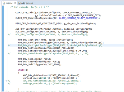

Hello Community,
I am trying to read the input supply ( voltage and current) through ADC1.
ADC1_channel 6 is to sense the Input current and ADC1_channel 7 is to sense the Input voltage.
I am triggering the ADC1 with PDB1,
At beginning I have sensed the ADC1_channel 6 Input current and I got output current_mv as 1290 mv.
Later I added the ADC1_channel 7 Input current,
When I sense the both ADC1 channel, the current_mv result are modified from 1290mv to 537mv .
My voltage_mv is correct as per my requirement but the current_mv values are changing once I added the 2nd channel ADC1_channel 7.
There is no changes in supply but I am getting different ADC result. I have attached my project for your reference. Please have a look and let me know where I am going wrong.

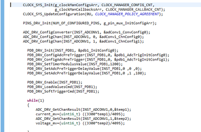

sarwath
I am suspecting my sample time and PDB timer and delay value. In my project I kept constant sampling time.
How to configure the different sampling time for different channels.

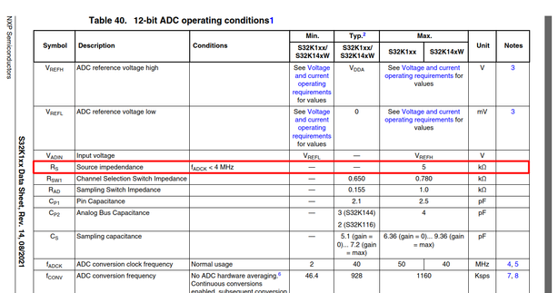

davidtosenovjan
Hi, If you don't have some error in SW configuration then it could be possibly caused by high impedance attached to the ADC input.
This device explicitly specify it as 5kOhm (max) at 4MHz (max).
Do you have it so?

sarwath
Hello @davidtosenovjan ,
Yes david. In my Hardware the source impedance is 159Hz. It is less than 4Mhz only.

sarwath
When I use the Software trigger for channel ADC1 CH6 , I am getting ADC result value closer to the Vin.
Then I configure the ADC (2 channels) with PDB trigger I am getting this value mismatch. I am reading RM and implementing but I am getting the wrong value in ch6 and ch7 value is valid (closer to the supply voltage). one channel value is correct and another channel value is wrong.
