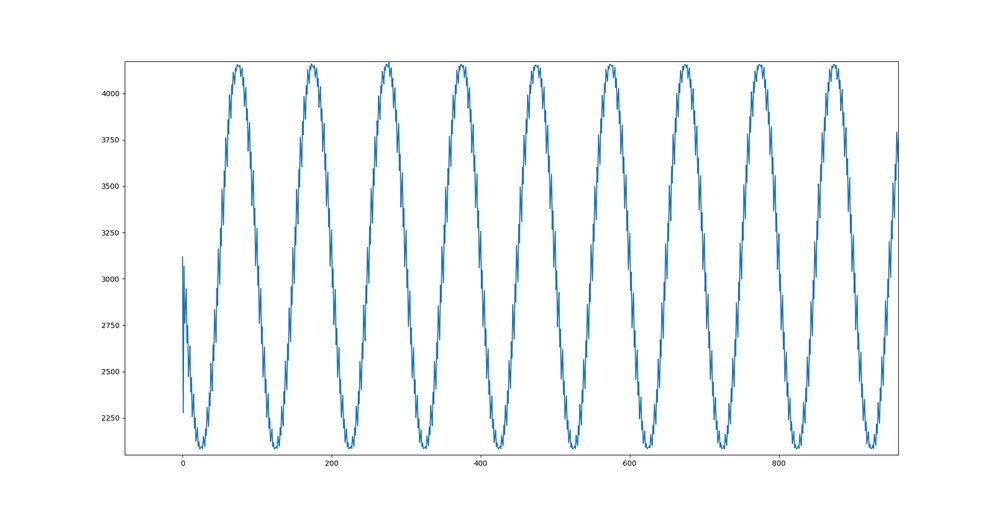

I used the PDB triggering in back-to-back mode to get ADC inputs from 2 or more channels. Did not implement the DMA yet, but I'm working on it.
I set the sampling rate at 40MHz and set up LPUART to transfer the recorded data at 115200 baud rate via PuTTY then, used python to plot graphs.
I was pretty satisfied with the data that I collected, the graph looks pretty decent.
Here's a graph of a sine wave at 500Khz.
7,926 Views

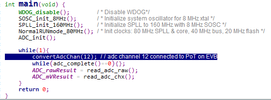

yrson7
Dear . Sadab Mahmud
I also under studding ADC high sample Rate.
I think convertAdcChan(12); was change like below.
