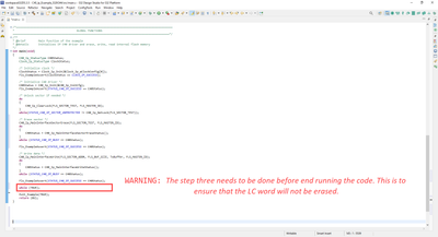

II. Write the LC word to the defined address:
Life cycle stage Valid Values for LC Advancement
OEM_PROD DADA_DADAh
IN_FIELD BABA_BABAh
Code Adjustments:
*                                       LOCAL MACROS
#define FLS_MASTER_ID                0U
#define FLS_BUF_SIZE                 8U
#define FLS_SECTOR_ADDR              0x007D2000U
#define FLS_SECTOR_TEST              C40_CODE_ARRAY_0_BLOCK_3_S489 /* Look into C40_Ip_Cfg.h file to find the corresponding sector */
*                                      GLOBAL CONSTANTS
uint8 LC_TxBuffer[FLS_LC_SIZE] = {0xDA, 0xDA, 0xDA, 0xDA, 0x0, 0x0, 0x0, 0x0}; /* Minimum data length 8 bytes */
Confirm the LC word using the Memory Viewer.

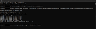

Step 3: Debugger Authentication
To unlock the MCU, PEmicro provides Python scripts (PEmicro support files package) to facilitate debugger authentication when the password is set.
In summary:
I. Ensure Python 3.5 or later is installed.
II. Open Command Prompt.
III. Use cd to navigate to the directory containing the file package.
IV. Run the script: py authenticate_password_mode.py -hardwareid=USB1 -password=…
  • hardwareid: Debug hardware IP, name, serial number, or port
  • password: 16-byte hexadecimal password
NOTE: This must be done every time the MCU is reset or power cycled.

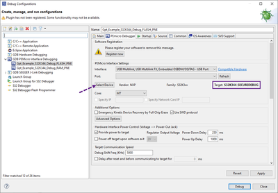

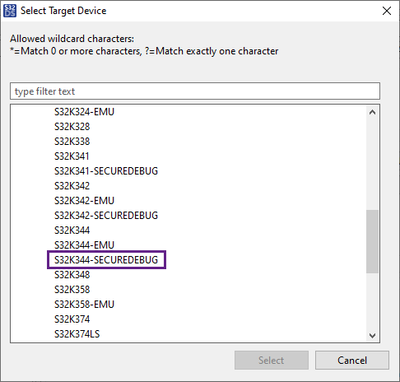

Step 4: Secure Debugging in S32DS
In S32DS, when configuring the Debug Configurations of a project, change the Target to "SECUREDEBUG". This is necessary because during debug entry, a hard reset is toggled, which clears the authentication.
Once authenticated, you can securely debug the device in S32DS.
