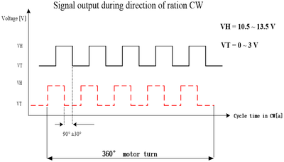

2.The relationship between the motor magnetic ring series and the output Hall waveform
5 pole pairs

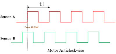

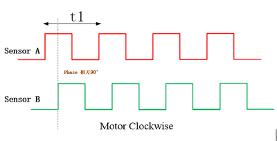

3.Determination of motor rotation direction
        The direction of the motor is judged by the phase difference of the two Hall signals. As shown in the figure below, the phase of Sensor A is ahead of Sensor B, so it can be considered that the current rotation direction of the motor is clockwise.

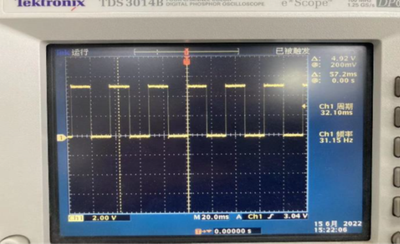

        Let’s do a test, the square wave in the below figure is the outputs of PTB12, and the output pulse period is 32.1ms. Then the time required for the motor to rotate once should be:32.1ms *5 = 160.5ms, then the speed of the motor should be: 60 * 1000 / 160.5 = 373.83rpm.
PTB2 output square wave

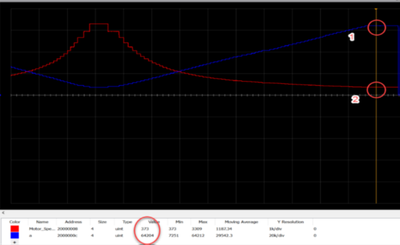

         The below picture is directly obtained by the debugger. It can be seen that the speed of the motor at this time is 373, which is not much different from the value measured by the oscilloscope, which is 373.83. This is because I did not use the floating-point calculation result in the program. In summary, we use the input capture function of the FTM module completes the calculation of the motor speed.
debuger monitor results

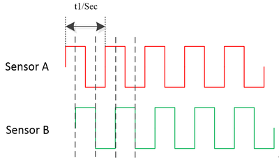

        Above we calculated the speed of the motor, but did not make judgement on the direction of the rotation of the motor. As mentioned above, the rotation direction of the motor is judged by the phase difference of the two Hall pulse waveforms. Usually, we think of using the timestamp to judge the current state of the phase, so we will enable the two input captures, and then calculate the two Halls timestamp of the falling edge of the pulse.
        In fact, there is a simpler method, it only needs to read the high and low state of the other Hall pulse level when the falling edge of one hall pulse is interrupted. In short, we only need to enable one input capture, and the other to be used as a GPIO port.
