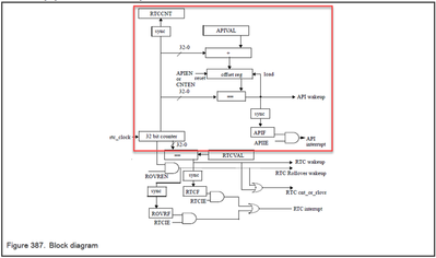

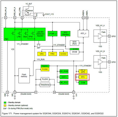

This example routine configures the WKPU & RTC units for wake-up. The RTC is present in always ON domain, hence available in RUN mode as well as in STANDBY mode.
The chip contains one instance of RTC (Real Time Clock) timer and API (Autonomous Periodic Interrupt) timer, where both can perform 32-bit comparisons. Both RTC and API timers can generate interrupts as well as wake-up from low power modes.
The following figure highlights the path for RTC API wake-up. Please refer to Chapter 69.3.2 API functional description from the S32K3XX reference manual (Rev. 12) for further information.
