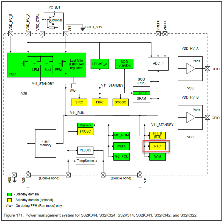

This example routine configures the WKPU & RTC units for wake-up. The RTC is present in always ON domain, hence available in RUN mode as well as in STANDBY mode.
The RTC can trigger a single wake-up event (timeout). When the RTC counter reaches a specific, pre-defined alarm time set by the user.

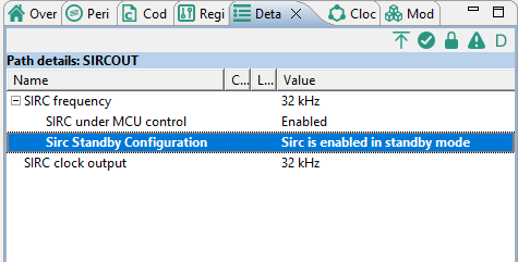

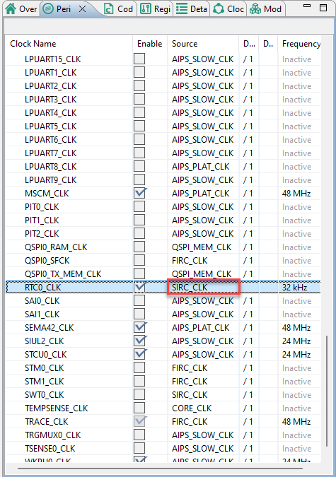

RTC timeout is mapped as wake-up source 1. RTC0_CLK source is configured as SIRC_CLK, and SIRC_CLK must be enabled in standby mode.
Chapter 69.3.1 RTC explains the functionality of the RTC timer. RTCVAL is updated at the point where no counter match is due as per the previous RTCVAL, the RTCF flag is set when the counter matches the new value. If there is a match when in the low-power mode, then the RTC first generates a wakeup request to force a wakeup to run mode, and then the RTCF flag is set.
The routine waits for SW5 to be pressed, then turns off the green LED, and enters Wkpu_EnterStandby() function which:
  1. Switches CORE_CLK to FIRC.
  2. Initializes the WKPU instance.
  3. Configures WKPU1 & WKPU42 (PTB19).
  4. Initializes and enables interrupt for RTC.
  5. Loads the RTCVAL value to 5000ms.
  6. Starts the counter.
  7. Enters standby (or fast standby).
