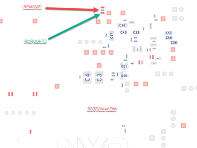

There are a few reworks needed on the EVB in order to make the code work.
S32K3X8EVB-Q289 Rev B2:

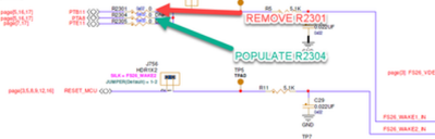

1.- Remove resistor R2301 and place R2304 instead, this change is because the PTA8 signal has the EXTWAKE option on the user push-button, this allows that when you send a WKPU request from the MCU (with the push-button) what the MCU does when it has PGOOD activated is that it sends an EXTWAKE signal to WAKE1 of the FS26.

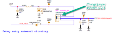

2.- Change the J685 jumper position to 2-3, this jumper is the VDEBUG mode.

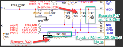

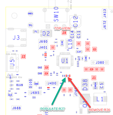

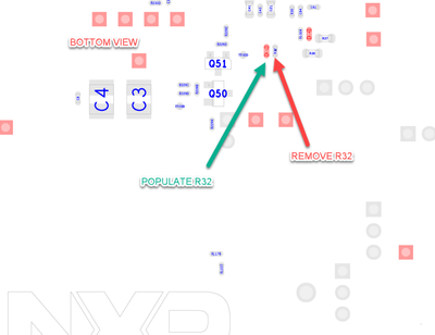

3*.- Optional: FS26 DS recommend FCCU lines with certain values of resistors on their lines that are not present by default on the S32K3X8EVB-Q289.
