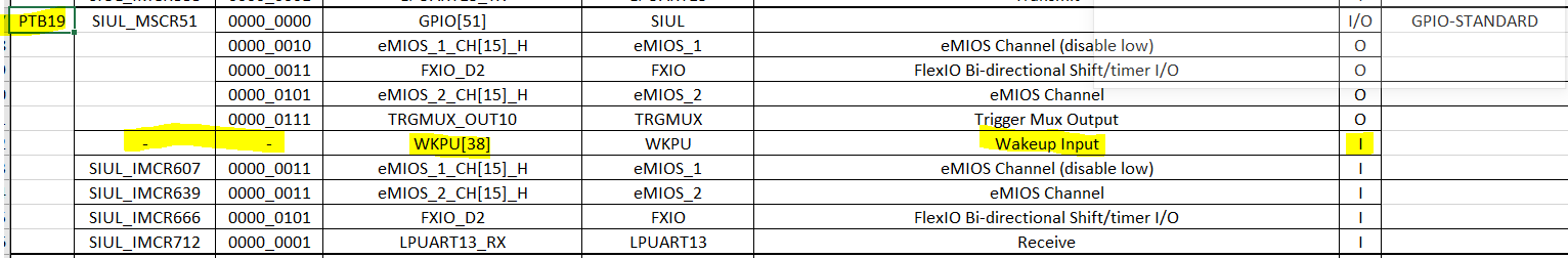

SW-5 = PTB-26  -----> PRESS to enter the STANDBY mode.
SW-6 = PTB-19 = WKUP[38] --> PRESS to exit the STANDBY mode.

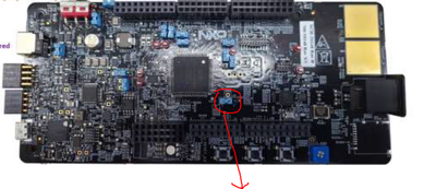

* Test HW: S32K3X4EVB-T172

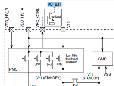

********* If you use external BJT on your board to generate 1.5 volts *******************
I tested on Our T172 EVB, with NPN external Ballast transistor is selected to supply the V15_MCU domain. I am able to wake up from standby mode.
If we select 2-3 in J31 then NPN external Ballast transistor is selected to supply the V15_MCU domain & wakeup is ok on T172 EVB
