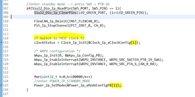

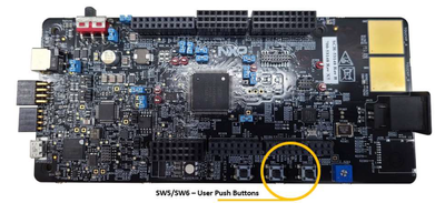

SW-5 = PTB-26  -----> PRESS to enter the STANDBY mode.
SW-6 = PTB-19 = WKUP[38] --> PRESS to exit the STANDBY mode.
CAN-0-RX = PTA-6 = WKUP[15] --> send CAN message to exit the STANDBY mode
The example uses PIT-0 timer, to generate the periodic interrupt.

* Test HW: S32K3X4EVB-T172

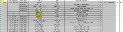

Wake-up source, SW-6 GPIO:--
Wake-up source, CAN-0-RX :--
According to the IOMUX table in RM, for example, PTA6 can be used as WKPU15 and CAN0_RX. It means that the WKPU15 input doesn't require specific MSCR configuration.
So if its input buffer is enabled and the corresponding WKPU input channel is enabled/configured in the WKPU, it should be able to act as wake-up input.

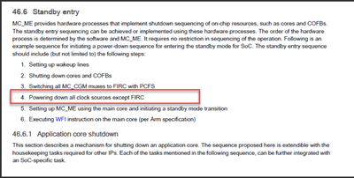

Standby entry :--

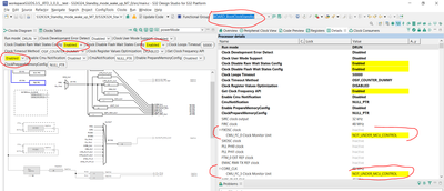

STandby clock :--
Enter Standby mode :--

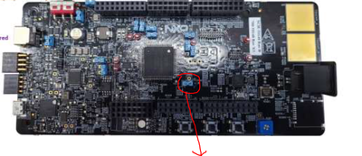

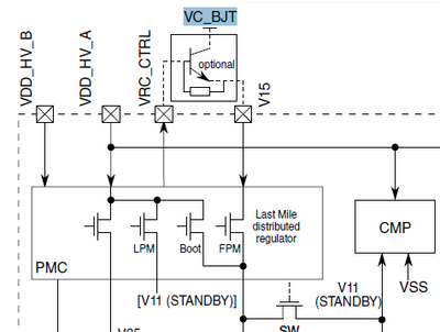

********* If you use external BJT on your board to generate 1.5 volts *******************
I tested on Our T172 EVB, with NPN external Ballast transistor is selected to supply the V15_MCU domain. I am able to wake up from standby mode.
If we select 2-3 in J31 then NPN external Ballast transistor is selected to supply the V15_MCU domain & wakeup is ok on T172 EVB

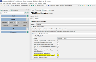

You have to make following settings in code :--
