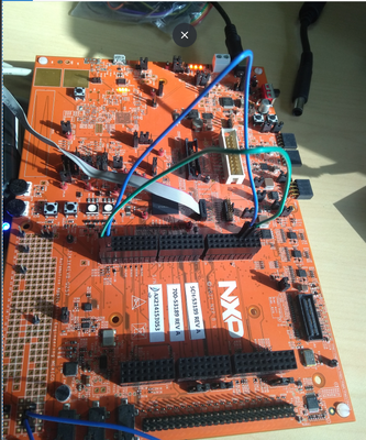

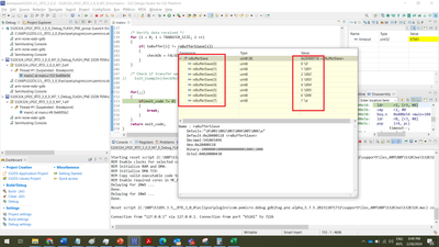

 The purpose of this demo application is to present a usage of the
LPI2C-0 as MASTER and LPI2C-1 Slave, using DMA for TX & RX for the S32K324 MCU.
* Test HW: S32K3X4EVB-Q257
* MCU: S32K324
* Compiler: S32DS3.5
* SDK release: RTD 3.0.0
* Debugger: PE micro
* Target: internal_FLASH
