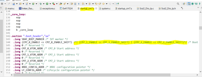

Jump is decided based on the boot_header, size we use to jump to the RESET handler:--

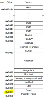

Cortex M-7 Interrupt vector table, RESET handler is 4 byte offset from starting of vector table :--

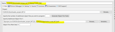

How to burn elf file of both application & bootloader code :--

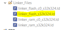

Bootloader Linker file used :--
Application Linker file used :--
This linker file has provision to distribute RAM to both the cores
Application & bootloader both commented this, as CORE-1 should be started in CORE-0 main() function if required  :--

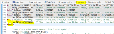

System.c file this changed (as in RTD-3.0.0 bug in startup file because of which HARDfault occurs in startup process for S32K324) :--
