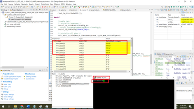

 The purpose of this demo application is to present a usage of the
 UART IP Driver for the S32K3xx MCU.
 The example uses LPUART6 for transmit & receive five bytes using the Interrupt.
* Test HW: S32K3X2EVB-Q172
* MCU: S32K312
* Compiler: S32DS3.5
* SDK release: RTD 3.0.0
* Debugger: PE micro
* Target: internal_FLASH
