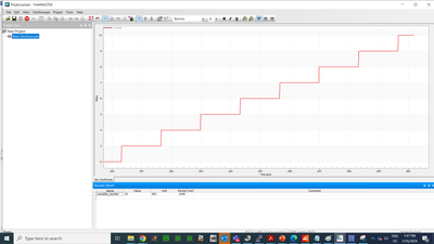

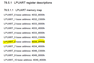

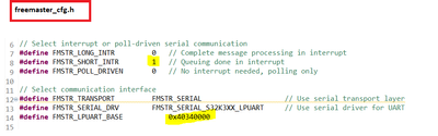

 The purpose of this demo application is to present a usage of the
 UART IP Driver for the S32K3xx MCU.
 The example uses LPUART6 for Freemaster uart Port.
Freemaster project :--
S32K312_Freemaster_UART6\GUI_new\Project.pmpx

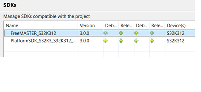

* Test HW: S32K3X2EVB-Q172
* MCU: S32K312
* Compiler: S32DS3.5
* SDK release: RTD 3.0.0
* Debugger: PE micro
* Target: internal_FLASH
Dinesh_Guleria_4-1705393832494.pngDinesh_Guleria_4-1705393832494.pngDinesh_Guleria_5-1705393840809.pngDinesh_Guleria_5-1705393840809.png
