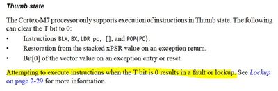

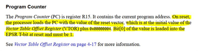

Jump is decided based on the boot_header, size we use to jump to the RESET handler:--
Dinesh_Guleria_0-1708069834663.pngDinesh_Guleria_0-1708069834663.pngDinesh_Guleria_1-1708069881672.pngDinesh_Guleria_1-1708069881672.png
Cortex M-7 Interrupt vector table, RESET handler is 4 byte offset from starting of vector table :--
// Reset_Handler+1  --> required in IVT, to avoid hard fault
As per Arm®v7-M Architecture Reference Manual  --> DDI0403E_e_armv7m_arm.pdf
