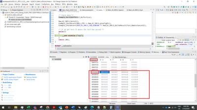

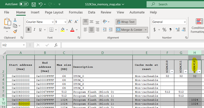

 The example uses MEM_InFls driver to write 128 bytes to FLASH memory address  0x50_0000 .

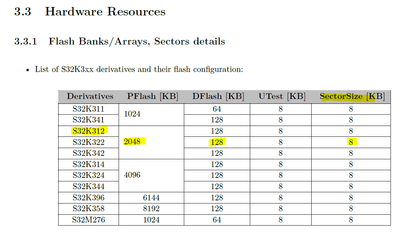

Results :--

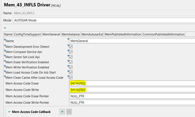

Ram location where FLASH writing erase code is placed :--
I placed the code at 256 byte below the MAX address of the RAM size
0x20417DAA = 541162922
Size of RAM need to save the flashing routine, as per the MAP & linker file :--
0x00407e64 - 0x00407e38 = 44 bytes

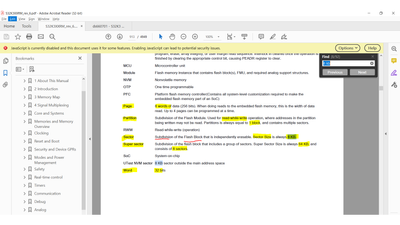

 S32K3 FLASH Memory Terminology :--
