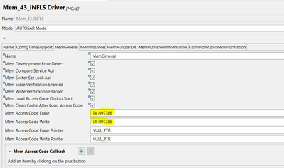

 The purpose of this demo application is to present a usage of the
MEM_InFls MCAL Driver for the S32K3x1 MCU.
 The example uses MEM_InFls driver to write 128 bytes to FLASH memory address  0x48_0000 .
* Test HW: S32K31XEVB-Q100
* MCU: S32K311
* Compiler: S32DS3.5
* SDK release: RTD 3.0.0
* Debugger: PE micro
* Target: internal_FLASH
Results :--

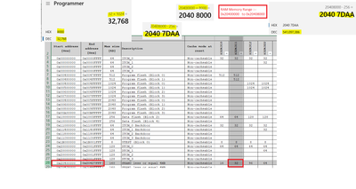

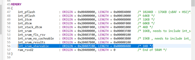

Ram location where FLASH writing erase code is placed :--
I placed the code at 256 byte below the MAX address of the RAM size
0x20407DAA = 541097386

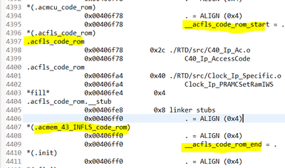

Size of RAM need to save the flashing routine, as per the MAP & linker file :--
0x00406ff0 - 0x00406f78 = 120 bytes

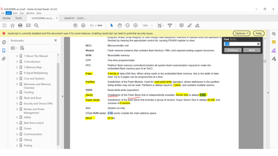

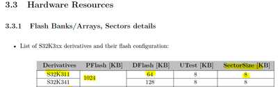

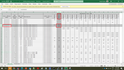

 S32K3 FLASH Memory Terminology :--
