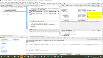

The purpose of this demo application is to present a usage of the
EMIOS IP Driver in Polling mode for the S32K3xx MCU.
The example use to :--

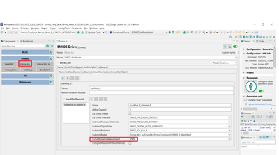

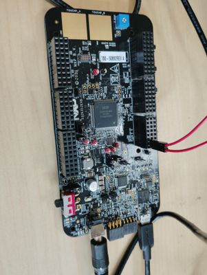

EMIOS-1 - ch-0  --> PTC24 --> Generate the PWM
EMIOS-1 - ch-1  --> PTC25 --> is the ICU channel to measure the duty
Pins used :--

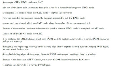

This example is tested for IPWM mode .  :--
IPWM mode ,  ICU Driver User Manual :--
Result :--
* Test HW: S32K3X2EVB-Q172
* MCU: S32K312
* Compiler: S32DS3.5
* SDK release: RTD 3.0.0
* Debugger: PE micro
* Target: internal_FLASH
