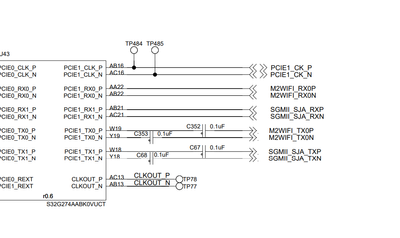

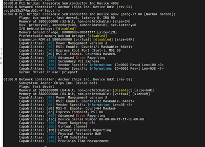

When we plug our wifi module into the S32G274ardb2 development board, lspci shows the following.
Network controller is our device
The follows are our own development board

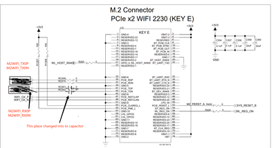

The two figures above are our circuit diagrams.

 We can't see the devices information in lspci -v.

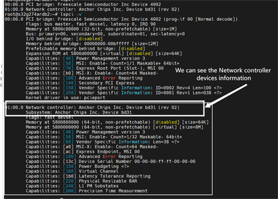

We may not be understanding fully what the problem under your setup is, we see both images showing information when using the lspci -v command, while you say that you are not getting the information, but we see information on both images. If you can help us providing more information, we can provide better support from our side. We do apologize for the inconvenience.

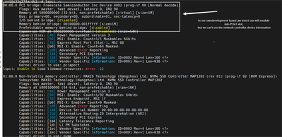

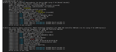

Our BSP version is 38.0. We want to mount our WIFI module on the PCIe slot of the S32G274a. On your official development board s32g274ardb2, after we insert our WIFI module into the PCIe0 slot, we can view our device information through the lspci -v.
However, when we insert the WIFI chip into the PCIe1 slot on our own designed development board, we cannot view the device information of our WIFI module through lspci -v. 
 The changed of the circuit diagrams was shown above

For what we can also understand, under the NXP platform you cannot reproduce the behavior, hence we assume the behavior might be related to HW/SITA. As you have shown previously, there are additional capacitors to the lines.

Could you tell me what HW/SITA stand for? And regarding the issue of capacitors, could you please provide more helpful information?
And in our new development board the pcie0 is working properly.However, we are not sure if the problem of pcie1 is with the hardware of software.Please give us more help,thank you
