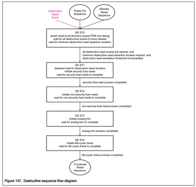

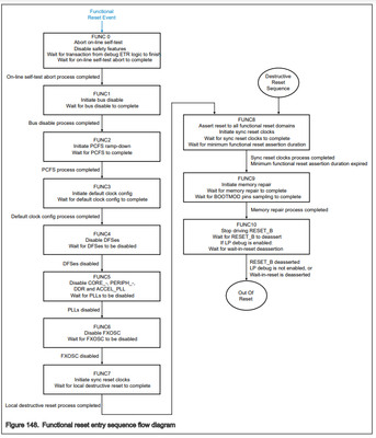

For functional safety, sometimes we want to put certain external ports to high-impedance (or a trustable state), i.e. to shutoff CAN , when system fails. However in S32G series, I haven't seen similar configuration. I want to check if you have similar design, or we have to do external design by ourselves using the FCCU/FS0B. Thanks!

Icespring
Hi Miguel!
Thanks for your reply! It really helps!
Furthermore, I want to check that when a reset is triggered by MC_RGM, will it FIRST set all the pins to their default state, THEN start the reset sequence? Is this order certain for all the reset?
Thanks!!

Miguel04
Hi @Icespring
It seems that the information you are looking for can be found in figures 147 and 148 from the reference manual, these figures describes the sequence for functional and destructive resets with a flow diagram.
Let me know if you have any question.
