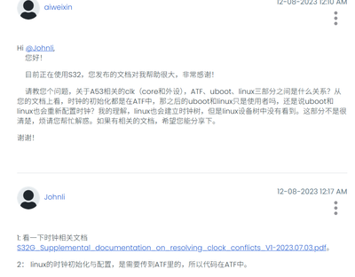

I now have some questions about the clock in the S32G, basically similar to the questions in the picture;
1. won't tf-a exit after tf-a initializes the clock?
2. how does u-boot and kernel initialize or use the clock,Need to communicate with tf-a?
3. can you explain in detail how clk is used in tf-a, u-boot and kernel?
https://community.nxp.com/t5/NXP-Designs-Knowledge-Base/S32G-Bootloader-Customzition/tac-p/1771379/e...
