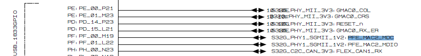

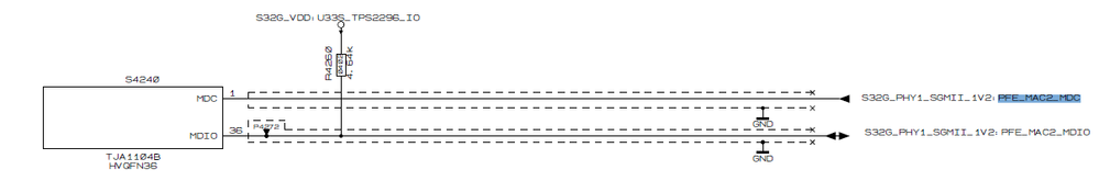

Dear All,
I am using a custom s32g2 based hardware platform in which PFE2 is designed to work as "sgmii" using Serdes0 XPCS_1 channel 0
There is a PHY "TJA1104B" used in design
The pin details of MDC/MDIO is as mentioned in the the Schematic section attached.

The problem is correct mux setting which is commented above does not work (Pin 80,81), but the which is UN-commented as above works (Pin 82,79)
This is very strange.
Can you suggest as how this is possible ?

1. Per your description, if connecting the PHY to the S32G2 like the following:
Then setting the corresponding dts(79, 82), the PFE2 could work correctly, is it right?
2. If reworking the board, connect the PHY to S32G2 like the following:(no any other modification on the schematic?)
With only corresponding dts settings modification(80, 81), the PFE2 could not work as expected?

I Chenyin,
I have made it work, the issue was PHY address. When i changed it to correct value with correct pin mux (80,81) its working in the kernel.
