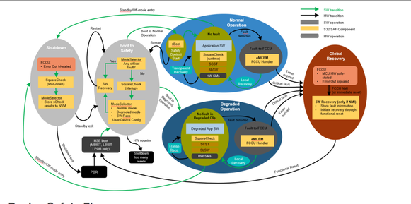

Is there any configuration to perform transition to 'Boot to Safety' when sBoot returns E_NOT_OK?
Currently, Mode selector is in bootloader. and sBoot is in application.
How can the transition be achieved? Is it via configurations? Or any sBoot APIs available?
In Safety Manual, it's mentioned as hardware transition.

Hello, @Irshad2225
Sorry for late reply.
1. Is there any configuration to perform transition to 'Boot to Safety' when sBoot returns E_NOT_OK?
[A]: The transition mentioned is an abstract flow, no clear configuration is implemented.
2. How can the transition be achieved? Is it via any configurations? Or any sBoot APIs available?
[A]: You could trigger reset or change the code flow(such as change PC pointer) to complete the transition, there is no sBOOT API available.

2,291 Views
chenyin_h
Hello, @Irshad2225
Thanks for your post.
I am working on your questions, may I know if you are referring to the diagram below:
Chenyin
