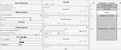

youke
Hi,chenyin
I tested debugging with PFE-DRV_S32G_M7_MCAL_1.3.0\example_application\run_main_RDB2.cmm and it works correctly;
Test qspi startup by adding the blob file as follows:
BR.

youke
Hi, chenyin
I haven't made any corresponding modifications to the initialization code; I only commented out some unused functions in the main function.
These are the QSPI-related parameters in IVT. Could they have an impact?
What other modifications do I need to make?
BR.
