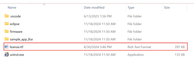

Below is our all step. Currently, we still not knows how to update recipes.
Put the LLCE-firmware and license.rtf (license is from S32G_LLCE_GATEWAY_1_0_9_D2408.exe)
Rename license.rtf to license-llce.rtf
Enable llce-can feature in machine conf and update license-llce.rtf md5sum
Build image and flash image to SD card. We will get probe pending in kernel log

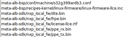

Joey_z
hi,GG0712
Are you mean delete original inc file then rename bbappend file to inc ?
>>>It needs to change the original inc to bbappend file.
But how LLCW fw put into image?
>>>You can refer to the picture.
Joey

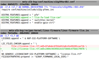

In addition, could you try the file in picture and not add the logger config.
Joey
2,272 Views
GG0712
Hi @Joey_z ,
We can build success after rename the target file and modify md5sum value
But the driver have the same issue during probe.
2,267 Views
