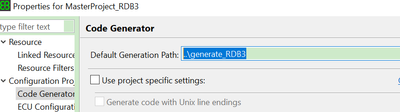

Let me summarize the building steps for your reference:
  1. Install the following packages SW32G_RTD_4.4_4.0.2, PFE-DRV_S32G_M7_MCAL_1.2.0, PFE-FW_S32G_1.7.1 to your host.
  2. Create link file under $EB_PATH/links with the content:
path=$SW32G_RTD_4.4_4.0.2_PATH
  1. Copy the plugin from PFE DIR: Eth_43…. to the $SW32G_RTD_4.4_4.0.2_PATH/eclipse/plugins
  2. Import the project: MasterProject_RDB3 to the EB
  3. Generate project code by EB, by default, the code path is shown below:
After successfully generation,
Copy generate_RDB3/* to $PFE-DRV_S32G_M7_MCAL_1.2.0\example_application
  1. Open the project_parameters.mk, At least modify the following part: change the path depending on your installation.
GCC_DIR ?= c:/NXP/S32DS.3.5/S32DS/build_tools/gcc_v9.2/gcc-9.2-arm32-eabi #depend on your path
TRESOS_DIR ?= C:/EB/tresos    # EB installation path
PLUGINS_DIR ?= $RTD_4.0.2_installation_path/eclipse/plugins
TRESOS_WORKSPACE_DIR ?= $(TRESOS_DIR)/workspace
FW_DIR ?= $pfe_FW_installation_path
  1. Build the project by typing “make HW=RDB3”
Hope it helps
Best Regards
Chenyin
