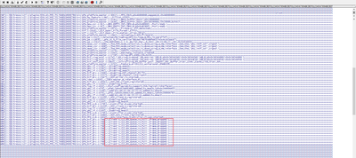

I use llce_sample_app_pfe to run ETH2CAN can't work normally, Because I can't receive the  CAN frame normally. But in this sample I can get the acf-can frame,whether this routine can only implement CAN2ETH, but not ETH2CAN?
Also, in data.dump debug_buff, there are some information  Client's (1) RX queue is full. Frame dropped. Is this normal phenomenon?

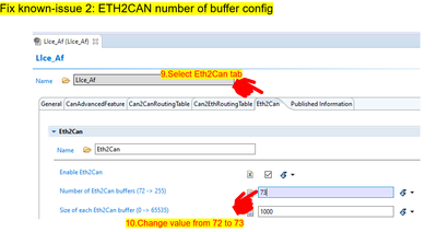

Thanks for the information. Ther are 2 known-issues under the above mentioned LLCE v1.0.4 example. One is the ETH2CAN buffer configurations.
Have you done any modifications to the project?
The ETH2CAN buffer config change is the following:

seeu

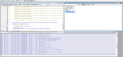

I chang the value from 72 to 73, now the frame drop problem were solved. But I can't still receive the can frame from ETH2CAN. Because I comment the CAN2ETH code, and use tcpreplay to send the ETH packet to PFE_MAC1(P3A connector),and run the code,  Logic analyzer can't receive CAN frame, and the variable rxIndicationCount=0 .

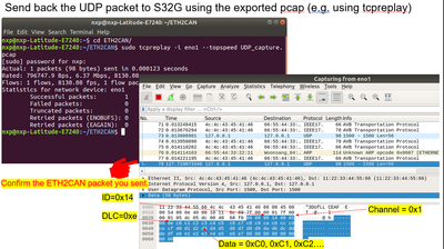

The recommended way of doing the ETH2CAN channel is to select the UDP packet being sent with the CAN2ETH feature then sending it back:
Is this what you are doing?
