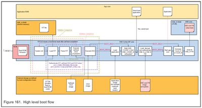

I got this in the manual,
Says there is an BootRom firmware within the chip.
We are currently troubleshooting an booting issue, and doubt if this bootRom firmware was a customize one that modify our EEPROM by mistake.
Notice this EEPROM was used as the device in serial RCON booting.
So, could this BootRom firmware be modified by someone?
Thank you in advance.

The BootROM available under the S32G platform is not modifiable. We do apologize.
Please, let us know.
