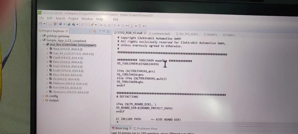

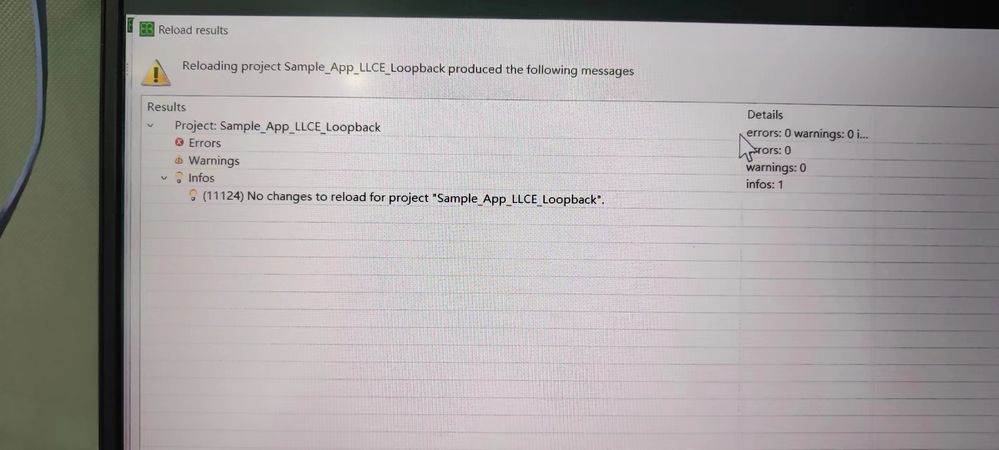

After installing EB tresos AutoCore, I was able to import the goldvip gateway project normally and the loading configuration was normal without any exceptions. However, when I imported the can loopback project in llce 1.0.5, there was no error in loading the configuration as shown in Figure 1. However, all modules in the project were grayed out and disabled as shown in Figure 2. After enabling the module by right clicking, an error was reported as shown in Figure 3
figure 1
figure 2
figure 3
  How can I solve this problem so that I can configure the can loopback project?

We understand that the GoldVIP project requires modifications to the plugins of EB Tresos (adding and modifying plugins). LLCE examples for EB Tresos seem to have problems with these modifications, hence they are not able to be imported if GoldVIP project has been imported previously.
We can recommend either creating a new environment for the required plugins without modifications, or reinstalling EB Tresos to reset the plugins.

Thank you for your reply. I have reinstalled eb29.0 and can load the can loopback project configuration normally. The goldvip gateway project still uses eb29.2 for configuration
