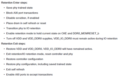

Daniel-Aguirre
On regards of DRAM retention, the following information is provided under the S32G2 RM [Page 1566, S32G2 Reference Manual, Rev. 7, February 2023]:
Don't know if it helps.
Please, let us know.

starface42
Thank you for your response.
I understand that retention is about maintaining DRAM data even when the power is off.
Is there a way to prevent certain areas of DRAM data from being cleared when the SoC is simply reset
(either from a reset in U-boot or a reboot command in the kernel)?
Thanks!

Daniel-Aguirre
Thanks for your feedback. The following is told under the S32G2 RM:
For which, the steps provided before, should enable the retention either under the standby power state or a functional reset.
As for specific areas, we are not seeing anything on this regard. We understand that all the DRAM values are being retained under this mode.

starface42
Sorry for getting back to you late. I’ve taken a look at what you suggested, and it seems like it doesn’t quite fit with what we need.
We’re planning to go with having the M7 core reset the A53 core, so we can avoid a direct reset of the DRAM. Haven’t started implementing it on the M7 core yet, though.
Thanks a bunch for your help.
