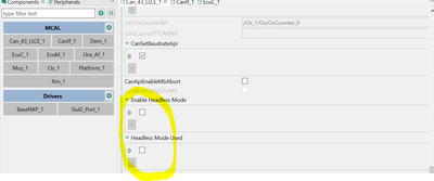

We are trying to build Can_Llce_DS_Can2Can_S32G399A_M7 example in LLCE 1.0.7.
We are following the description, there is a point which mentions following :
Where do we find the checkbox?
We are using S32DS 3.5.3 , RTD 4.0.2 and LLCE 1.0.7

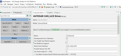

You may try reference the following:
ConfigTools->Peripherals
Then press Can_43_LLCE_1->CanGeneral
Stroll down to find the two options related with headless mode as decribed, press the plus icon and then the checkbox could be shown.
Hope it helps.
