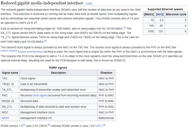

RGMII is a standard, for which the overall required signals should be same regardless of the chip/family/supplier. The following is mentioned under the following link (Media-independent interface - Wikipedia
Which should be the signals required for an RGMII interface. The name could vary, but the functionality should remain the same.
The IOMUX file shows the functionality regardless of the interface, since the MACs can work with MII/RMII/RGMII. Depending on which interface you are working with, you need to select the signals you require to use.
Again, we could be misunderstanding this last request. If so, we apologize.
