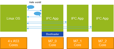

Since both start M core(APP) and A core still no good, and refer to the attatched document,
I want to start  Linux form M7_0 bootloader all lone (not include M7 APP).

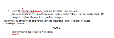

  • 4:checkout arm-trusted-firmware (release/bsp33.0-2.5) and buid it (`FIP_ALIGN := 64` and unset LDFLAS because I had a "aarch64-fsl-linux-ld.bfd: unrecognized option '-Wl,-O1'" error)
  • 5:Build the ATF  and got a fip.32 the address info as blow:
    • IVT Location: SD/eMMC
    • Load address: 0x342fc580
    • Entry point: 0x34302000
  • 6:renew fip.32
dd if=fip.s32 of=/dev/sdb skip=512 seek=512 iflag=skip_bytes oflag=seek_bytes conv=fsync,notrunc

Because I want to start both A53 and M7 from M7, I broke down the steps, first BOOTROM>M7_ 0(bootloader)-> A53_ 0. If this is successful, then BOOTROM ->M7_ 0(bootloader)-> M7_ 0(App)
Spoiler
Also, the fip.s32 is not to be used on QSPI if it was not built to work with QSPI, there should be another fip file that was created for the QSPI interface.
If you look at the attachment I uploaded, you will know that the actual startup sequence I used  is BOOTROM ->M7_ 0(in Nor Flash) -> fip.32(in Nor Flash) -> u-boot(in SD), not BOOTROM ->M7_ 0(in Nor Flash) -> fip.32(in Nor Flash) -> u-boot(in Nor Flash), so,  I think configure TF-A to read the FIP image  is unnecessary.
Unfortunately, the problem returns to the point that I have been confused,
That is how to verify the following startup process in the simplest way:
QSPI startup mode
BOOTROM->M7_ 0(bootloader)->A53_ 0(FIP)->M7_ 0(APP output "hello world" to UART1)
                                                             L______-> A53(U-Boot->Linux)

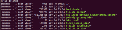

1:refer to the GoldVIP binaries and GoldVIP document, we found the following files that you provided.
And I dd the fsl-image-goldvip-s32g274ardb2.sdcard to SD card and burnt the boot-loader and fip.32-sdcard to QSPI Flash, the Linux can start normally in QSPI mode.
Alao I hexdumped the  fip.32-sdcard and you can the IVT image is on the 0x1000,
that is the position of  IVT in SD mode.

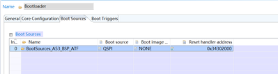

I used the UART sample of RTD, and configured the bootloader like blow:
StanleyShen_2-1673601508581.pngStanleyShen_3-1673601519971.pngStanleyShen_4-1673601536904.png
And I burnt both bootload, ATF(SD-Card and QSPI ), UART sample with windows GUI tool
the UART0 can be output normally like blow but UART0 still NG
I also give the IVT compilation log. Can you give me some suggestions?

"- we retake our point, the fip file you are using is the same you used for your SD boot? if so, this is wrong. You should use a fip file configured to work from QSPI."
Below should be a capture of what is provided inside the NXP BSP 33.0 binaries folder, under the RDB2 sub-folder.
In which 2 fip files are provided, one for SD and one for QSPI.
For what you have been telling us, you are using the same fip file you used (and worked) on the SD interface. This should not work on the QSPI interface.
Have you tried (at this point in time) to boot up linux (without M7 into the equation) from NOR Flash?
From the first point you mentioned "...and fip.32-sdcard to QSPI Flash, the Linux can start normally in QSPI mode." and also "...I hexdumped the  fip.32-sdcard and you can the IVT image is on the 0x1000." we understand you tried this option, but it is not explicitly mentioned.

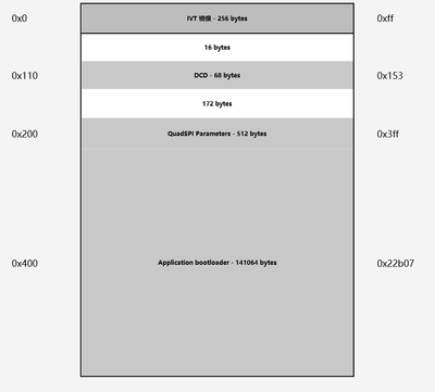

In QSPI mode, S32G looks for the IVT on 0x0, not 0x1000 [Table 137, Page 1146, S32G2 Reference Manual, Rev. 6, 11/2022], which the IVT for the fip file you are using is located, but you still got it working in QSPI mode.
We suspect you got your platform to boot up from the SD (not QSPI), which is expected from the steps you mentioned (and files you used).

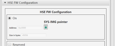

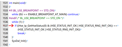

  2. I tried to debug the bootloader.elf file that I attached, it stopped at HSE firmware initialization, is  there a problem here?(I think it should be because of the debugger, because I unchecked the [secure boot] at Bootloader(…)->EcuC(…)->Bootloader(…)-> Bootloader->General and the debug is OK,but start A53 still NG)
Maybe I still missed something, but there is still no special progress so far. Please help me.

参考附件的Enabling Multicore Application on S32G2 .pdf就可以成功了,
注意烧到NORFlash的一定要是fip.bin。

你还是需要在理解一下AN13750的case,这个case的最终结果并不是所A核和M核要有东西打印,
其核心是测试IPCF来测试IPC通信是否正常(如下图)
所以在这个case中,如果要确认M核是否起来,可以参考PDF的22页的内容,
通过Linux端的驱动发行IPC消息给M核,然后M核把同样的消息返回给Linux,
具体内容如下:
$echo 1 > /sys/kernel/ipc-shm-sample-instance0/ping
$echo 1 > /sys/kernel/ipc-shm-sample-instance1/ping
$echo 1 > /sys/kernel/ipc-shm-sample-instance2/ping
$dmesg | grep ipc-shm-sample_multi-instance
[ 462.703716] ipc-shm-sample_multi-instance: starting demo on instance 0...
[ 462.703739] ipc-shm-sample_multi-instance: INST0 ch 0 >> 19 bytes: SENDING MESSAGES: 1
[ 462.703753] ipc-shm-sample_multi-instance: INST0 ch 1 >> 32 bytes: #0 HELLO WORLD! from KERNEL
[ 462.703797] ipc-shm-sample_multi-instance: ch 0 << 19 bytes: REPLIED MESSAGES: 1
[ 462.703818] ipc-shm-sample_multi-instance: ch 1 << 32 bytes: #0 HELLO WORLD! from CORE 4
[ 462.703850] ipc-shm-sample_multi-instance: exit demo for instance 0
[ 470.935633] ipc-shm-sample_multi-instance: starting demo on instance 1...
[ 470.935653] ipc-shm-sample_multi-instance: INST1 ch 0 >> 19 bytes: SENDING MESSAGES: 1
[ 470.935667] ipc-shm-sample_multi-instance: INST1 ch 1 >> 32 bytes: #0 HELLO WORLD! from KERNEL
[ 470.935712] ipc-shm-sample_multi-instance: ch 0 << 19 bytes: REPLIED MESSAGES: 1
[ 470.935732] ipc-shm-sample_multi-instance: ch 1 << 32 bytes: #0 HELLO WORLD! from CORE 5
[ 470.935763] ipc-shm-sample_multi-instance: exit demo for instance 1
