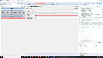

i found the TCP/IP stack and it is installed in the S32 Design studio, i am trying to compile the lwip_s32g274a example, but i am getting error in freertos,
I have added the Packages of FREERTOS, RTD, TCP/IP Stacks are all installed in the IDE,
Kindly help me in fixing this error,

Hi Daniel,
I am able to compile the project, i had a issue with the packages installed in the PC, so now build is fine
i am facing issue that, whenever i run the project it is going into the dev_Assert handler,
for physical connections i have connected the ethernet port of RGMII with the PC and both are in same network 192.168.0.1 gateway,
Even when i try to ping the IP of 192.168.0.200 , i am not getting any reply
in discription i found that HSE need to flashed, is it mandatory to flash the CPU,
if it is mandatory kindly provide the Links and documents regarding how to do it
Thanks in advance

Naveenkumar_Muthusamy
Hi Daniel,
Thanks for your continued support.
Now we are able to ping the Board from PC and workaround you have suggested is working
