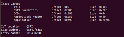

I am sorry I still don't think so, pls let me explain the reason

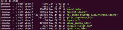

1:refer to the GoldVIP binaries and GoldVIP document, we found the following files that you provided.
And I dd the fsl-image-goldvip-s32g274ardb2.sdcard to SD card and burnt the boot-loader and fip.32-sdcard to QSPI Flash, the Linux can start normally in QSPI mode.

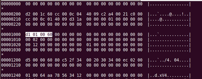

Alao I hexdumped the  fip.32-sdcard and you can the IVT image is on the 0x1000,
that is the position of  IVT in SD mode.
2: I downloaded the u-boot and make s32g274ardb2_qspi_defconfig  and create IVT image with arm-trusted-firmware, but still NG(burnt it to NOR Flash but no any message outputed on UART0)
I also confirmed that this FIP file is available(no burnt linux image to QSPI)

In QSPI mode, S32G looks for the IVT on 0x0, not 0x1000 [Table 137, Page 1146, S32G2 Reference Manual, Rev. 6, 11/2022], which the IVT for the fip file you are using is located, but you still got it working in QSPI mode.
We suspect you got your platform to boot up from the SD (not QSPI), which is expected from the steps you mentioned (and files you used).

Since I reconfigure the IVT image like blow, it seems that both A53 and M7_0 were startup OK
and between Linux Kernel and Cortex-M7 cores the IPC communication was OK too.
  - we would like to confirm if you can boot-up Linux from NOR Flash using the A53 core. This can be done directly from S32DS and by following Section 4 from AN13750.
About this,  I still think that the content in Section 4 describes starting Linux from SD card instead of NOR Flash.
