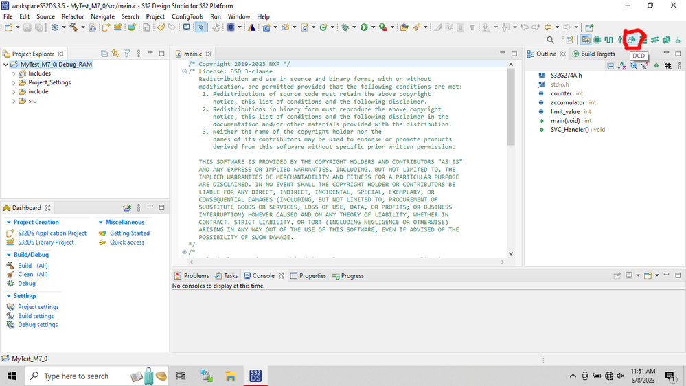

I think you have not created configuration. do as below after creation application project.

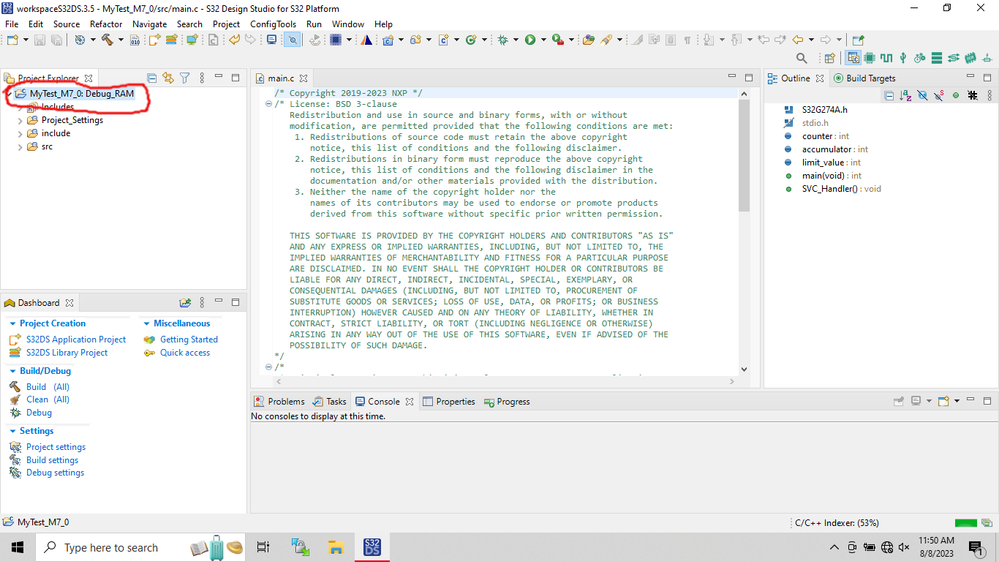

i.e I have created application project name as "MyTest"
Select the project in Project Explorer bar shown as below

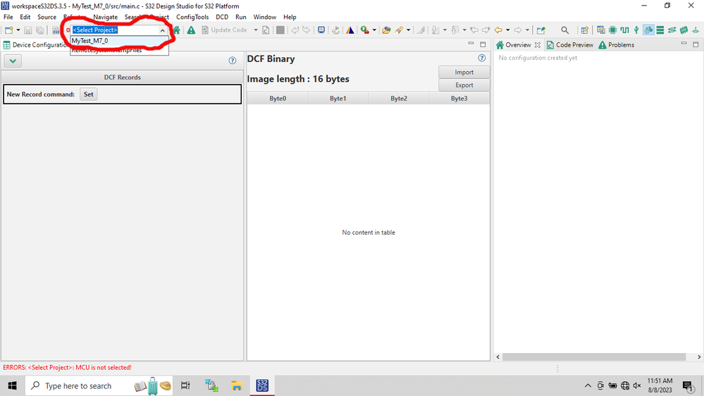

Now Select DCD tool shown as below
Now Select the project as shown below

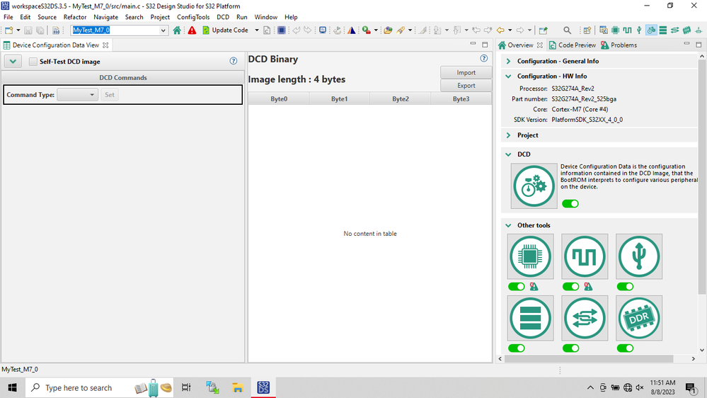

Now DCD confrontation will open as below. you can config DCD here

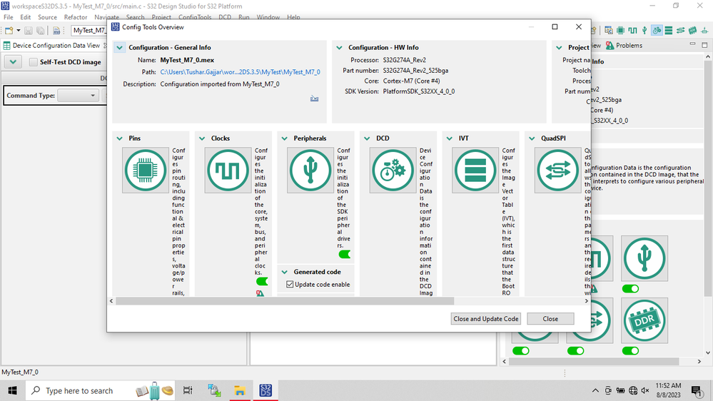

Now open Config Tools Overview you will see  as below

Unfortunately I can select my test project in the DCD view but it will not be locked in by the tool. The menu jumps back to <Select Project>.
